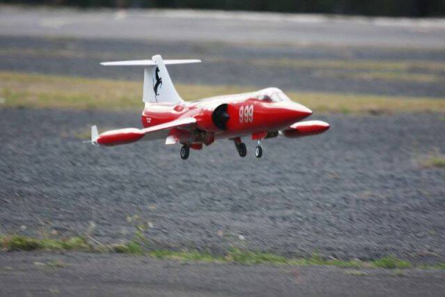

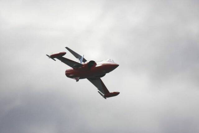

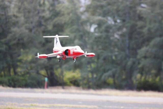

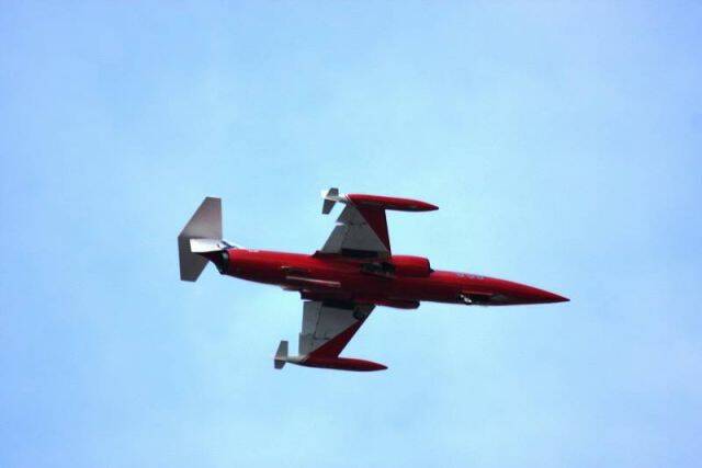

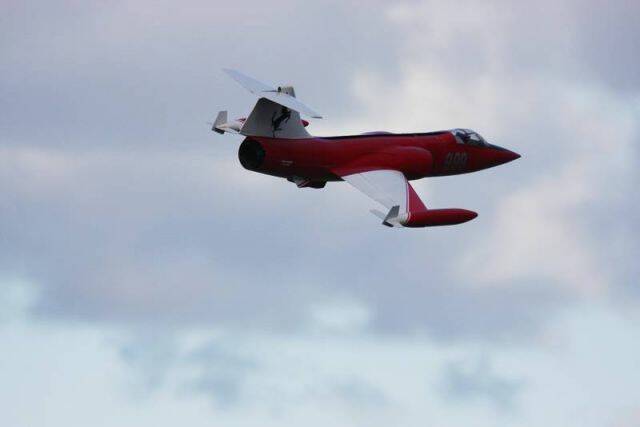

這是住在美國夏威夷的飛友使用Avonds F-104試飛行成功的照片,照片以下是他使用Kingtech K-80E的感想,他還很感謝他太太 Jill 一再替他拍攝飛行照片呢!
與大大們在此分享
Hello All

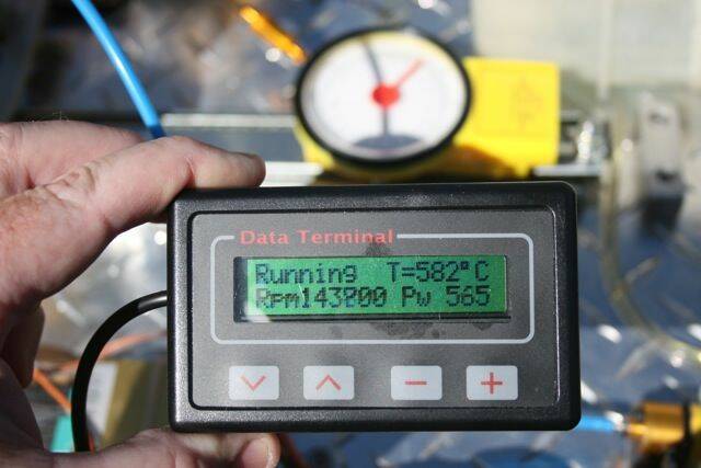

Well I have 5 flights on My Kingtech K80E now and it is running well. The throttle response is very good and it's very nice to have when it comes time to land the F-104.

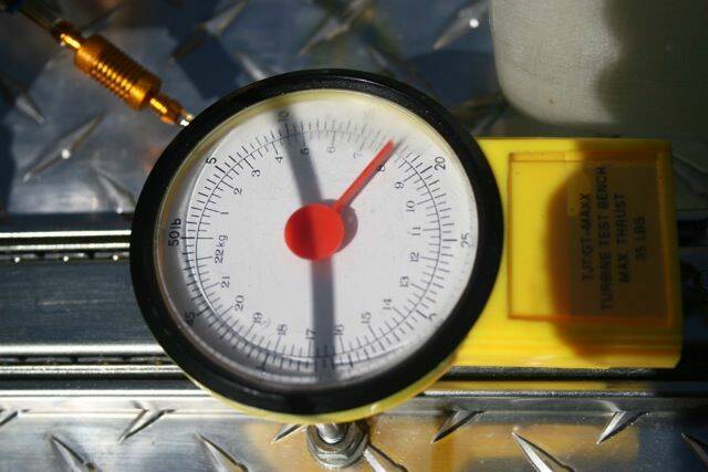

I'm sorry been too busy to get real numbers, however I can say that it is a nicely built turbine that runs smooth and is very fast throttling, I was able to get about 17.5 lbs on our test stand at sea level and 80 degrees F, the scale we use may not be completely accurate and our slides that we use are pretty old so we may have some friction losses on our stand. Actual thrust might be slightly higher.
I have been running 5 min flights and still have 34 oz left in the tanks when I land. I should be able to get the same 7 min flight time that I had using the old 54 sized turbine that I had installed. I will make an effort to video the performance and install next Sunday.
Great turbine im very happy with mine. Thanks to my Wife Jill once again for the great pictures!

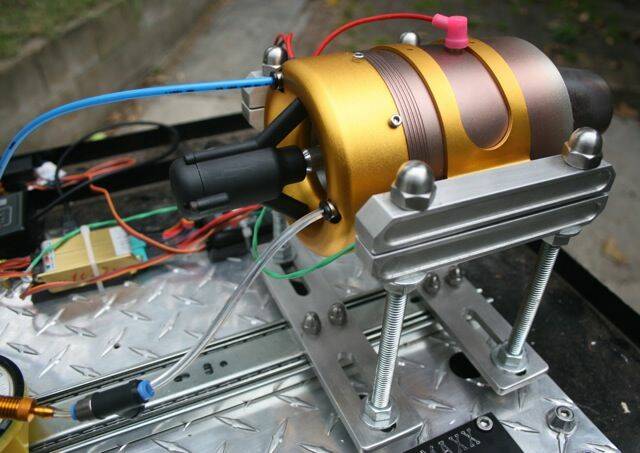

這是澳大利亞飛友在RCGROUPS網站所發表Kingtech K-80E的使用印象,有興趣的飛友可以瀏覽
http://www.rcgroups.com/forums/showthread.php?t=998859
感覺上他的測試載台比我先進多多呦
