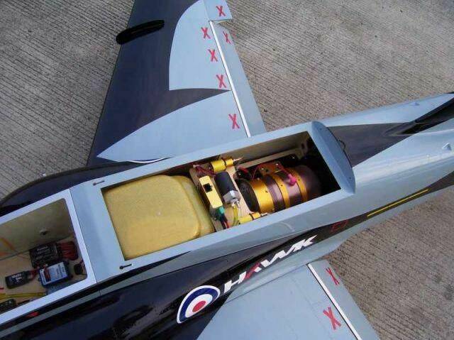

裝置國產Kingtech K-80E噴射引擎的Skymaster 紅箭〈BAE Hawk 〉由北部飛友Roger三月份試飛成功,這架紅箭〈BAE Hawk 〉起飛全備重量為14公斤,機身長2100mm.主翼長1800mm,推重比約為0.6。
                     雖然機體推重比較低,但是輕鬆的起飛與快意的特技飛行卻讓此一絕妙搭配成為CP值超高的搭配首選,請觀賞飛行影片

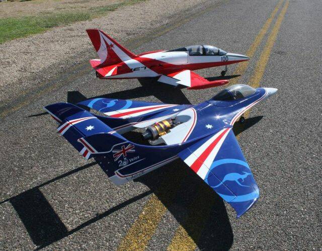

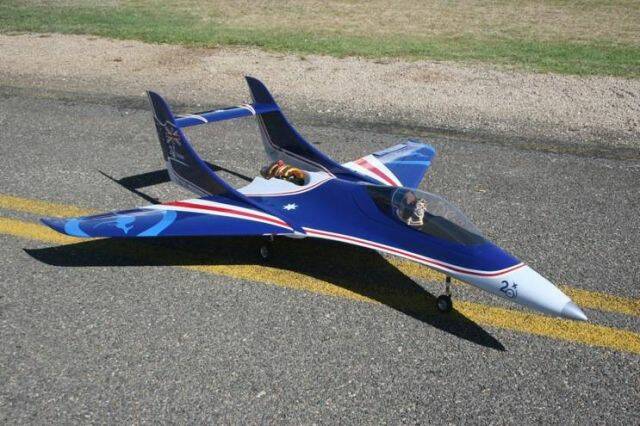

以下是澳洲飛友馬蒂使用Velox飛機裝置K-80E的飛行分享,Velox飛機飛行速度約在每小時240公里。
Heres my Velox with the K80E I have been flying the combo over the weekend and it has been performing well. Power is good and the only problem I had was during one flight with a flameout after performing a slow roll, this was traced back to air bubbles in the fuel line due to UAT not being correctly purged, once UAT was void of air bubbles the K80E performed 100% reliably on following flights.. I still have not yet had time to play around with the diesel or stock factory set parameters, acceleration and deceleration are fine as is for flying I have found and the auto start cycle to stable idle rpm is rather quick still, which is nice. In the Velox the K80E is about perfect with speed in the 150mph range. Iam liking this little engine more and more.....
