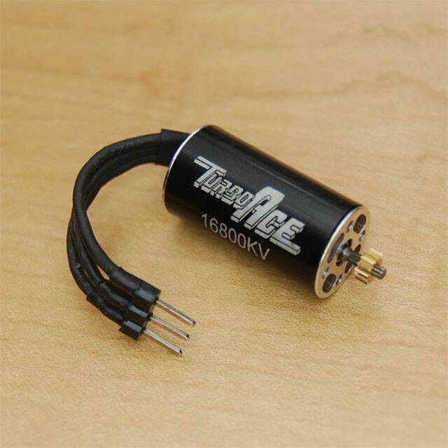

我就是想要拿小飛機這樣衝!不過這影片好像有改裝馬達
叫 TA 31714 "Black"內轉馬達

這讓人好心動阿,請問4#6s也能改成畫面那樣嗎?只要更換馬達還是須另改其他東西呢?這樣花下來大約需亦多少小朋友啊??

Turbo Ace 31714 Brushless Motor: 25-30% More Torque Than Stock, 14T Brass Pinion Installed, Powerful BL Inrunner Motor for Walkera 4G6 & 4#6應該是說比原廠動力多30%左右,這顆是內轉子無刷馬達,牌子型號 Turbo Ace 31714wowhobbies 網站好像很有名?他們賣的機子怎麼都是放這顆?國外的不同嗎... 美金34.95算成台幣要1100元
spec:
Kv: 16,800
Dimension: 25mmx12mm
Weight: including wires- without connector: 12.9g. Weight: including wires- with connector: 13.3g
ESC Requirement and Compatibility: Requires minimum of 8A. It is fully compatible with the Walker ESC without any cogging issues
Pinion: Walker compatible 14 teeth pinion fully installed and balanced
Motor screws: Not included but compatible with the Walkera stock motor screw
