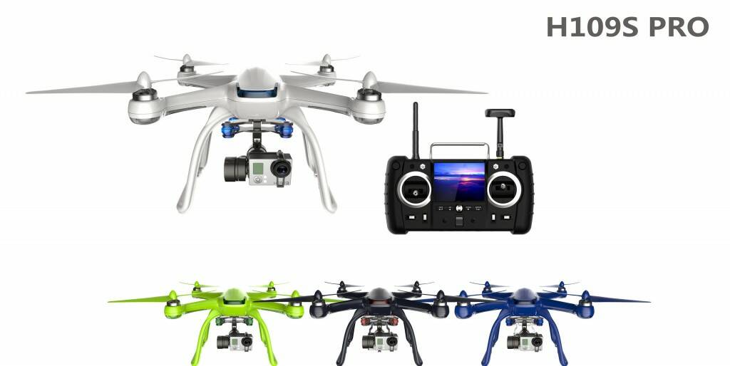

發表於 2014年8月14日 03:18 PM | 顯示全部樓層
之前這家出的標榜可飛40分鐘,但後來好像不了了之了,不知有沒有飛友買到這台
http://www.rcgroups.com/forums/showthread.php?t=2066943
Precise Aerodynamic light weight Design.
Super strong PC plastic material body design
Gopro 5.8Ghz live video without latency,(5.8Ghz VTX integrated design)
Video Distance:300-2000meters(clover leaf or patch antennas with different range)
11.1V 7000 mAh Lipo battery
Flight time:around 40 mins
Clover Leaf and Patch antennas exchangeable design enable you experiment real FPV.(antennas included)
Fatshark goggles compatible
Extended 2CH for your own DIY
3 D Camera Gimbal
Wireless Upgradable design for future update
Transmitter: FPV version (compatible with H302F Hubsan skycruiser)
Customer preference setting adjustable on TX(no need to connect to the computer)
Motor to Motor distance:260mm
ESC:30A
Multifunctional landing gear
Battery charging time adjustable.
GPS RTH
Headless mode
Barometer altitude hold
Safe return to home mode
APP Waypoint upgradable design
這台我也觀望了好久~近不來就是近不來  發表於 2014年8月15日 10:52 PM
