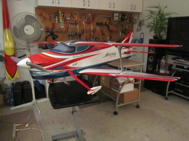

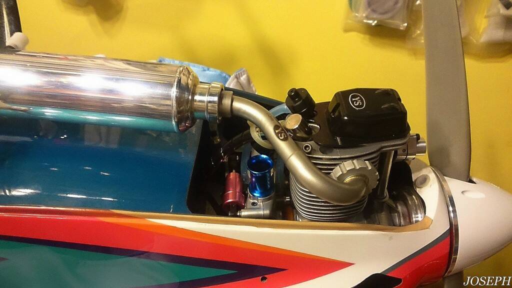

油雞的重量算法是不含燃料5000g就過關了,加滿油之後重量為5500g左右,以前ys175的馬力確實沒有馬達的力量大,但這顆ys185問世後補足了馬力不足的問題,再加上機子的重量比電機(含電池5000g)還重,所以更沒有怕風的問題,之所以小弟會重返油雞行列!

My Acuracy bipe.
Adrian
How is weight for your acuracy ? why you don't change for YS185CDI?  詳情 回復 發表於 2014年6月9日 02:30 PM

My GP is the very first one in production, & it's overweight, even without cdi. Oxai made a number of mistakes on mine & there were some parts missing. I reveived the plane early this year, & should h  詳情 回復 發表於 2014年6月9日 05:03 PM

My GP is the very first one in production, & it's overweight, even without cdi. Oxai made a number of mistakes on mine & there were some parts missing. I reveived the plane early this year, & should have waited much longer before ordering. By the way, I still have not had a chance to fly it yet ...
I was never much of a fan of cdi. Yes, it does give you a bit more torque, smoother transition & uses less fuel. However, when it started to have trouble, you will be chasing a ghost - it could be the spark plug, the electrode, the sensor, the cdi box, any or all of the above. All of my regular 170/ 175/ 185 runs great, & can easily be diagnose should something out of the ordinary happen.
Adrian
