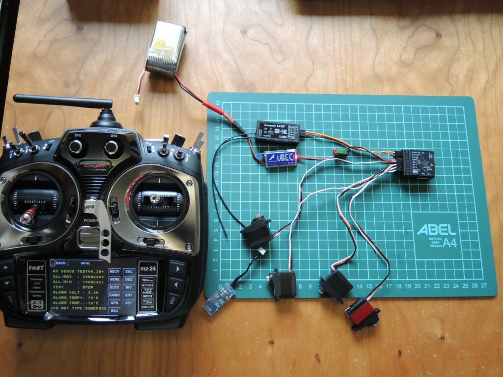

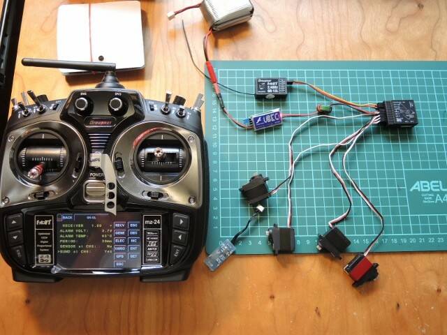

發表於 2015年5月22日 05:54 PM | 顯示全部樓層
本帖最後由 Philippewan 於 2015年5月25日 05:19 PM 編輯
派大派大好,好消息!美國的Ikon公司告訴我如何單線連接Graupner系統了。我快要搞懂了!
因為你這裡很多IKON/Brain的粉絲。借版面一下,給未來有Graupner又喜歡金腦的盆優們!

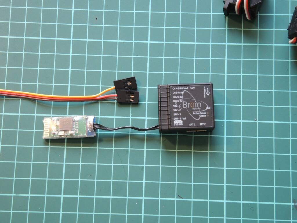

1. I am not sure if the GR12L puts out more than 6 channels on the when set for SUMD. Using the GR16L, It is also possible to program the channel 8 for the sum signal using a Graupner HoTT transmitter or the SMART-BOX (Order No. 33700). This is important for certain optional devices which require this signal.So you need to be sure you have done this programming with your receiver.
2. Select HOTT in step 2 of the ikon interface.
3. The wiring is shown in step 3. You need to make up this cable yourself. I have attached a picture of the cable (Using XBus, but the same cable....)要注意這條單線訊號線要放在中間位置,電源不可以插入第一插槽!切記切記,本人已經燒壞一顆金惱了。
There is only one way of doing this. Please do not try different methods!
Handmade cable
Handmade cable
