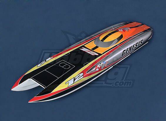

這台1M的船型和塗裝...感覺蠻喜歡的.................
Genesis Offshore Brushless RC Twin Hull
A fiberglass hull perfectly finished and with the right power train, a seriously fast R/C boat.
Spec.
Length: 1045mm
Width: 245mm
Height: 115mm
