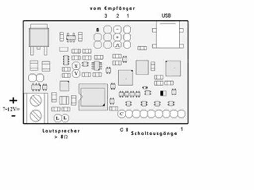

 樓主| 發表於 2011年3月1日 06:54 PM | 顯示全部樓層
跟德國人  一天一信 盧了好幾天  終於寄說明書給偶了
但素是徳文的....給他用''辜狗''翻成了不三不四的英文....
加減看看捏....
Soundmodul
Fish are dumb!
Well, you can not hear them at least.
Submarines can we not hear, but a
are some typical noise it anyway.
For every submarine film is a "ping".
In addition, all large submarines diesel engines,
the one with surface running well
can hear.
This programmable sound module was
developed for all possible models, a
fidelity and individual noise
to give. It can be a USB cable,
which is connected to the PC and with a
own software to fit any noise.
The submarine version is ready with typical
Sounds equipped and not readable, well
but overwritten.
The module is connected directly to a single output
connected. A junction at the entrance
for speed control of diesel can be speed-dependent
be.
Noise
The following noises are ready to be played:
Links 1: speed-dependent Diesel
Start and stop sound. (originalphoto
a diesel submarine)
Links 2: Alarm bell
Links 3: Call "alarm"
Law 1:
Ping
Right 2: Ping alternative
Right 3
Original ASDIC
Synchronously, the switching outputs
enabled:
Diesel
Output 1,
Bell
Output 2
Ping
Output3
               Technical data:
Supply: 7-12 V DC
Dimensions: 56x 35 x 12 mm
Storage Capacity: 4 MB
Thiscorresponds to about 3 `15 `` in
22 050kHz, or about6 `30 `` in
11 025kHz
Audio Output: 1.4 watts
Speaker:
8 ohms,
with a 4 ohm speaker
or shortcircuit, the
Amplifiersdestroyed
B= pins to enable the boot loader (activation
of software updates)
1 = input to activate the sounds of
remote control
2 = input of motor controller signal from thereceiver
3 = Input / output reserved for future use,
not currently in use.
X = channel 0 connecting external amplifier
Y = channel 1 connection of external amplifiers.
Use a 1μF capacitor per
for decoupling
Hardware into operation
To function properly, needsthe hardware, a supply voltage of at least7V up to 12VDC
(when using the attachableauxiliary amplifier
are allowed to14V). The voltagesource
should also providesufficient peak current
can. A batterywith at least 1 Amp peak current
recommended.
When connecting the battery to the polarity
to respect. Is connectedthe wrong polarity, passes
nothing, because abuilt-in reverse polarity
is, but it alsodoes not work. Inno Case, the operatingvoltage at thespeaker terminals Create
The outputs provideonly about 2mA,so sufficient
for a "low current LED. Willyou
switch larger currents, one has a transistor level
. bottoming
Up to16 sounds onthe remote control
activate a proportionalchannel
Operation is simple,either
on the control stickor maybe even
better a toggleswitch with 3 positions, with
the switch assoon as it leaves out, in the middle position
spring back. If you move the stick
or switch rapidlyseveral times into the "a "
Direction (eg 3times) and it can then
from, so sound isactivated 3 ofthe "one"side.
If you move the stick7 times, then Sound7
on or off. Thisis the same
the memory function.
The same typeof operation appliesto the "other "
Page. Each pageis assigned to 8sounds.
Header 2 ison pin 2 of theimpetus for the
Motor controller via a Y-cable.

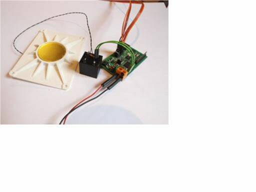

發表於 2011年3月2日 06:25 PM | 顯示全部樓層
哇嘎哈猴
那喇叭看起來不像線圈式 怎麼會有4-8歐姆規格
若是 那1.4w會粉小聲 沉到水里就聽不到
