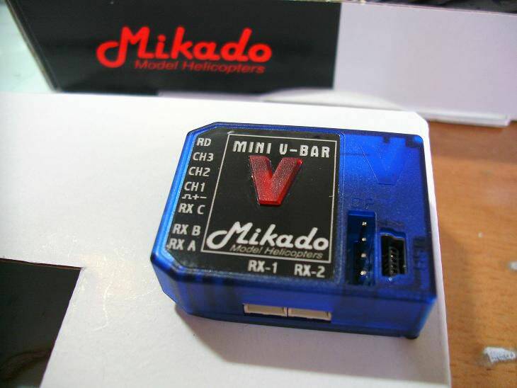

Mini V-Bar
Mini V-Bar

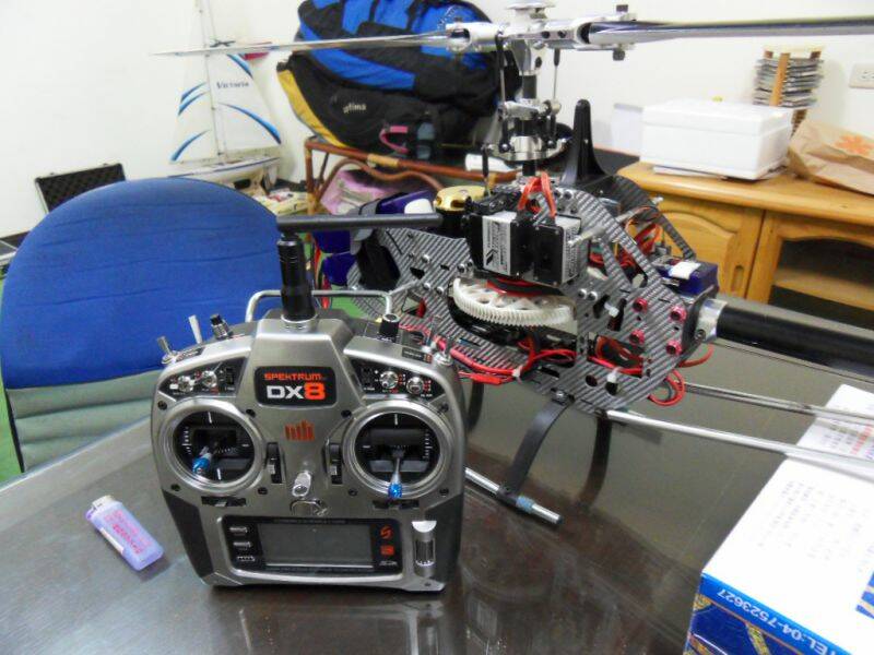

 樓主| 發表於 2010年12月14日 07:52 PM | 顯示全部樓層
用dx8連接收機都省了
配線更清爽
我下午有試spektrum satellites hires(1 or 2) 高速
2048 11ms 速度
我只接一顆衛星
沒啥問題
[ 本帖最後由 flypan1 於 2010年12月14日 07:55 PM 編輯 ]

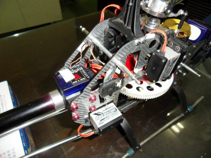

電池Turnigy nano-tech 3000mah 6S 25~50C Lipo Pack                 x2
伺服機Turnigy HV-787 Digital HV-2S Servo 8.44kg/ .033sec / 67g     x4
CC ICE HV 80A
CC BEC PRO  20A   7.2V
天蠍  4025  550kv   馬達齒10T   大齒盤110T
mini v bar  5.0.12  昇PRO 加小衛星
DX8  2048   11ms
發表於 2010年12月15日 12:17 PM | 顯示全部樓層
Spektrum Hires Mode[size=0.92em]31 October, 2010 - 01:35 — ulrich
Recently we discovered some problems with the Spektrum high resolution mode. It turned out, that it is currently not possible to run this mode with two satellites absolutely safe. Depending on unknown circumstances, it can happen, that the radio link is weak, which expresses in yerky running servos, and short dropouts. It appears to happen per bootup, so if the link is ok, it will stay ok, and if it is weak, it will stay weak.
Since this situation is not satisfying for me, i strongly recommend not using the high resolution mode anymore until a solution is available. Probably your setup is not affected, but since we cannot be absolutely sure on this, its safe to not use hires to completely avoid probable problems in the future.
Please go to the "Receiver" Tab at the Setup Screen and choose "Spektrum Satellites (1 or 2)" instead of "Spektrum hires Satellites (1 or 2)". Then redo the transmitter calibration, since the high resolution mode usese different centers and throws. I apologize for any inconvenience.
 樓主| 發表於 2010年12月15日 03:29 PM | 顯示全部樓層
原帖由 herbalist 於 2010年12月15日 12:17 PM 發表
Spektrum Hires Mode31 October, 2010 - 01:35 — ulrich
Recently we discovered some problems with the Spektrum high resolution mode. It turne ...
謝謝你提供消息
今天又飛兩次 感覺正常
我是5.0.12版
好像說明有更新這問題
有其他飛友有這方面的消息嗎
我飛的有一點怕怕
[ 本帖最後由 flypan1 於 2010年12月15日 03:31 PM 編輯 ]
