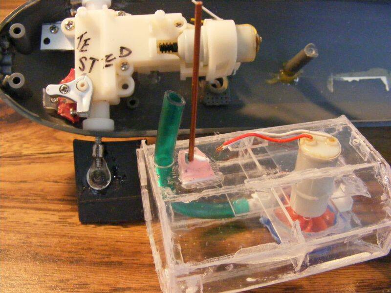

I am not going to keep my pump outlet ending below water level. It will be bundled with a smaller air tube and kept JUST ABOVE WATER LEVEL LIKE THE SUBMARINE SNORKEL. Complete submerging can then be done by slight inclination of diving plane. Positive bouyancy is always a good safety measure to prevent losing radio contact & subsequently your submarine.

 樓主| 發表於 2010年8月5日 12:08 AM | 顯示全部樓層
回復 40樓 epg800 的帖子
...泵口 不會低於水面. + 1 旁邊通氣管.
Thanks epg800.
