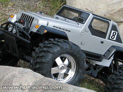

PRO-LINE的車殼不錯,也蠻堅固的~~
可以去逛逛喔~
http://w刪ww.prolineracing.com/catalog/Bodies-26-1.html
HPI的也很美~
http://w刪ww.hpiracing.com/hpibodies/truck/
