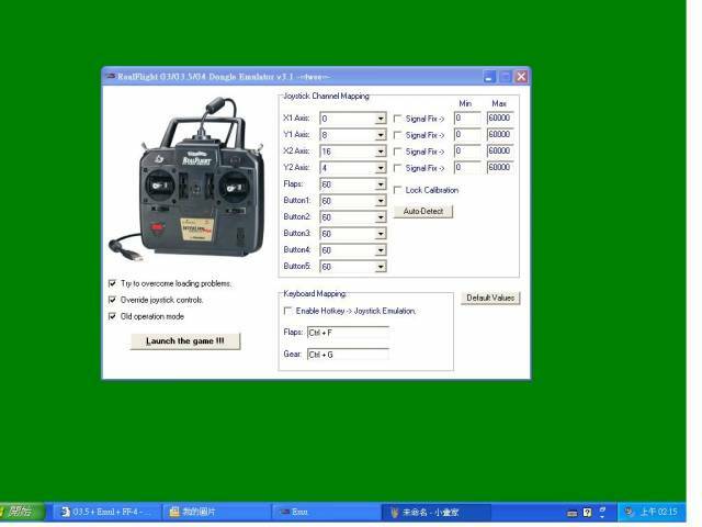

Emul 3.1 裡,可以不用設定(全部改 60 也可)~
G3.5:Controller --- Select Controller --- 1. Inter Link Transmitter 5 Channel. 或 2. Inter Link Joystick.~
Channel Mapping:1. Roll.  2.Pitch.  3.Throttle.  4.Yaw.  5. 3-Pos switch (Norm)/Smoke (Idle) 小動,尾巴可鎖定~
Knob (Idle) 大動,尾巴可鎖定~
Emul 先點出來,在點下面,"Launch the game" 去開啟 G3.5.....
我是用舊飛鷹模擬,來玩 G3.5~
G3.5裡都沒有去改,只有在飛機選擇裡點一架直昇機而以.......
~參考看看~
