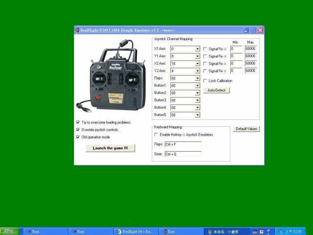

用舊的飛鷹模擬 usb 控制~
G4軟體 Controller --- Select Controller --- 1.Intel Link Transmitter 7 Channel...
Channel Mapping: 1.Roll.  2.Patch.  3.Throttle.  4.Yaw.  5.3-Pos Switch.  6.Knob. 7.Smoke.  8.DualRate....
Aircraft ---可自行選擇要練的機子 (例如) Doninion 90 3D --- 畫面右側有一個 Radio Type(Software 改為 Pass Through)....
搖控器FF-7有動到的地方:Reverse 2/3/6 頻道 改 REV...
D/R:可隨人調整....
CH:5-SW.G.....
CH:7-SW.E......
再來就是調螺距/油門曲調/陀螺感度.......
搖桿及各開關旋鈕校正都是照一般的步驟調整.......
~ 如此:可作到 Norm / idle 1~2 / Hold /  D/R / 陀螺感度 ~
Emul  X1 Axis:0.    Y1 Axis:24.    X2: Axis:20.    Y2 Axis 4.    Flaps:12.    Button 1:48.    Button 2:49.    Button 3:50.   Button 4:51.   Button 5:52 ~
