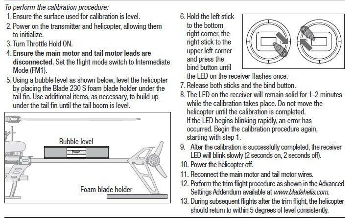

11/23 補充:
原本會往左前的機機
1.經實際升級,
2.用基本校正模式:
   a.為了安全主尾馬達拔線,將機機放置在水平位,尾定向片墊上所付泡棉拖鞋剛好水平
   b.正常對頻
   c.切hold,切到FM1
   d.依照以下搖桿扳法後按bind不放,會先閃一下,後恆亮,放開搖桿/bind,
   e.約數十秒會變成2秒亮,2秒滅(慢閃)代表成功
   f. 拔電
   g.OK
原本的trim flight 仍舊有,比較容易成功了
可參考這里
參考資料下載

If you have experienced issues with either the trim flight not recording properly, or the model
continuing to drift, follow these instructions:
http://www.horizonhobby.com/pdf/ ... on_Procedure-EN.pdf to calibrate your model.
After performing the calibration procedure, perform a trim flight to ensure optimum performance.

This Firmware update includes:
Calibration process
a) If an error occurs during a trim flight, the LED will flash rapidly after completion of the trim flight. Power down and perform the trim flight procedure again. If the issue persists, perform the user calibration routine.
b) The AS3X® auto trim memorization has been disabled. This may have resulted in a few cases of the yaw shifting from center in flight if the yaw stick was held off center and perfectly still. The control positions are memorized during initialization and the transmitter trims should not be used as they will cause the Agility mode drift.
