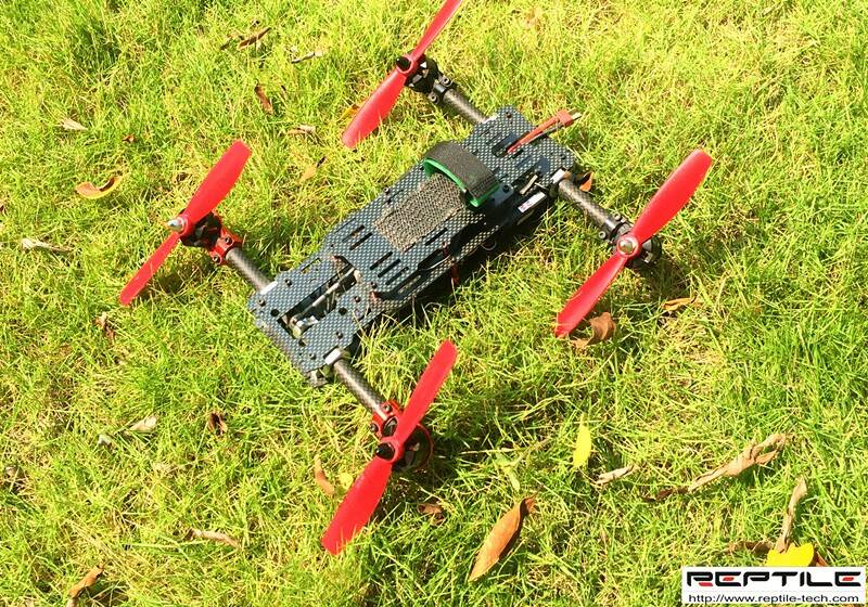

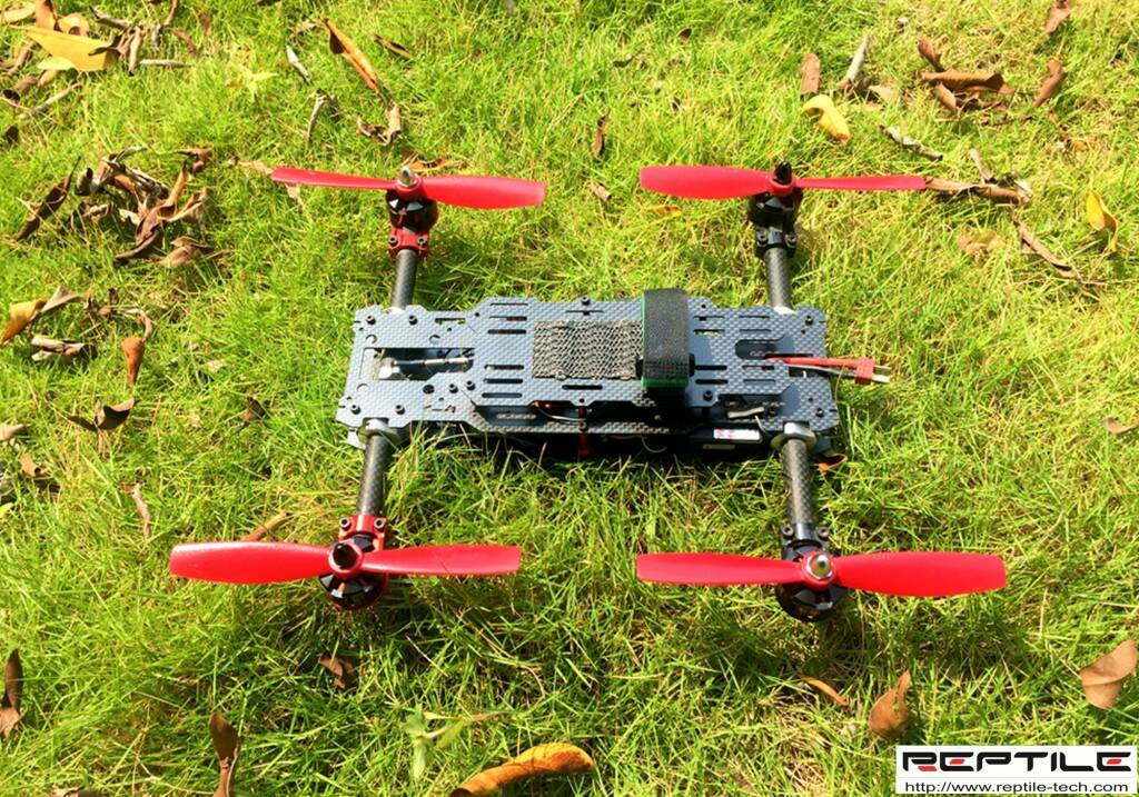

先放幾張照片
電機可以根據搖杆搬動幅度改變角度,從而改變機身的前進速度,角度越大,速度越快先看一個慢動作的
下麵拍的是一段正常速度的

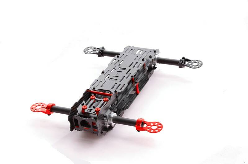

好像還沒放到掏賣...... 剛出來的新機
H4V-SPARK
Fuselage with 1.5mm thick Matt carbon fiber plate CNC cutting, machine arm is 12mm sub light carbon fiber tube, using CNC aluminum alloy of links, and use the bearing support motor tilt angle can in the change of plus or minus 40 DEG, the KST all metal steering gear drive motor angle change, ensure the deformation after the flight stability.
Wheelbase:300mm
propeller:6045
motor:2204-2206
ESC:12A-20A
Motor rotation angle:±40°
Weight:220g
Flight weight:<800g
