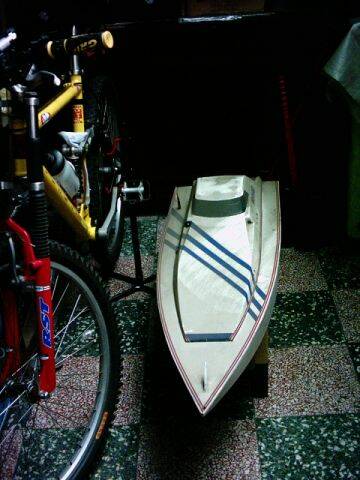

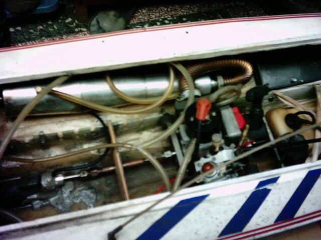

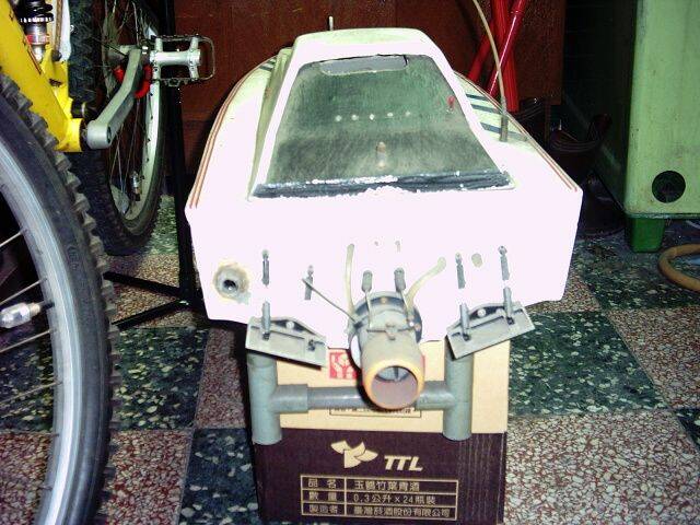

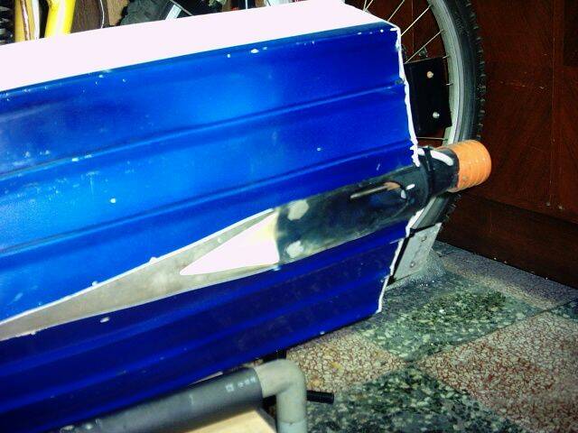

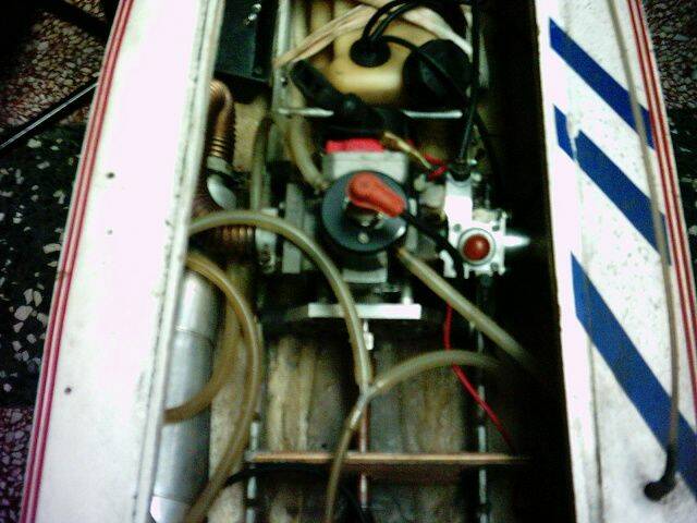

Deep V jet boat takes shape ... slowly Thought I would share my latest project ... have no clue if it will work
But with the amount of reading and questions asked too real jet boat builders .. I sure hope so.
Hull a Microburst 47", Engine a Sikk 25 or maybe a G260 ?, Pump a Swashdrive Gen II.
Above shot showing the intake pad (Called a Nacelle) Built from G-10 epoxy laminate, assembled and attached to hull with JB weld epoxy. Back cap will be the flat sealing surface for housing seal.
The Nacelle in place before attachment.
