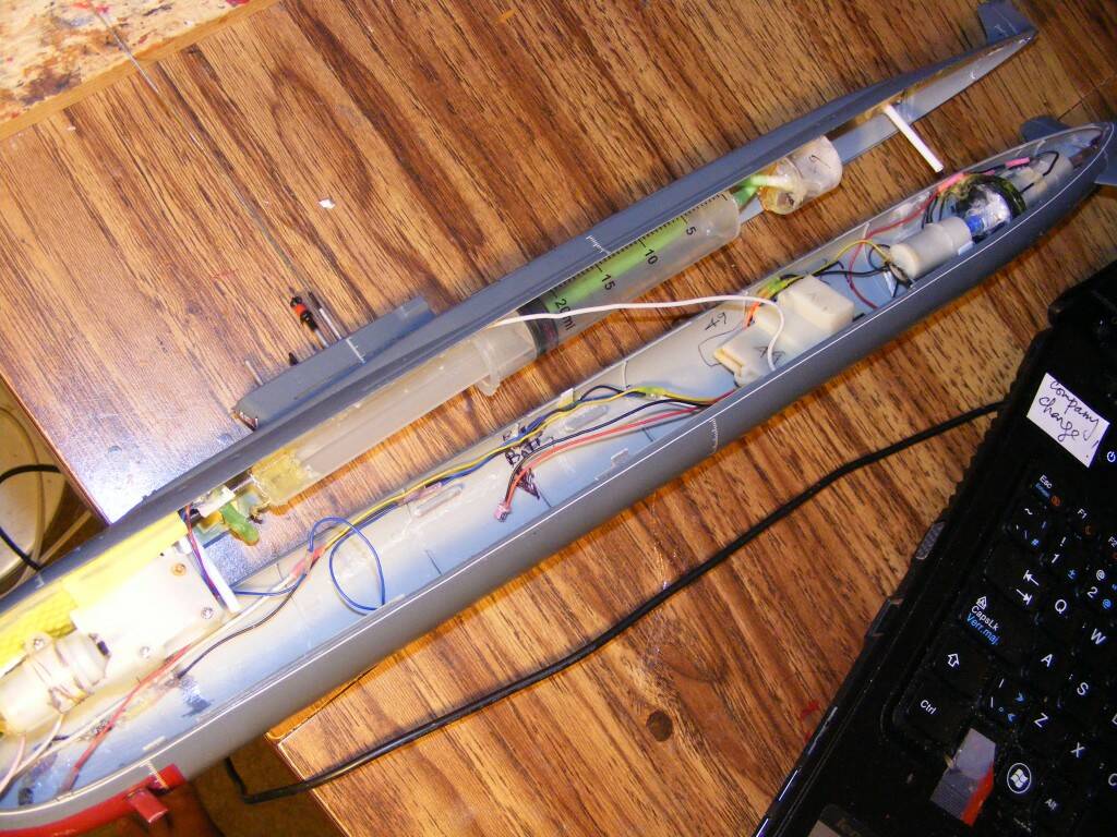

是1/350的模型改的吧 , 內構有相片嗎? 如此窄的艇身如何安裝遙控及動力裝備令人好奇.

謝謝賜圖, 研究之後有問題請教,
1. 電池放哪?
2. 如何吸排水下潛及上浮? 圖中看來是靠注射筒,但運作原理搞不清楚.
3. 潛舵及方向舵如何控制? 圖中看不到伺服器及連桿.

no chinese keyboard + don't know chinese physics words, you have to use translator if needed.
The water-proved battery is to be connected to the mini-plug shown. A gearbox pushes or pulls the syringe to dive or surface. Turning is by waterpump side-thruster.
