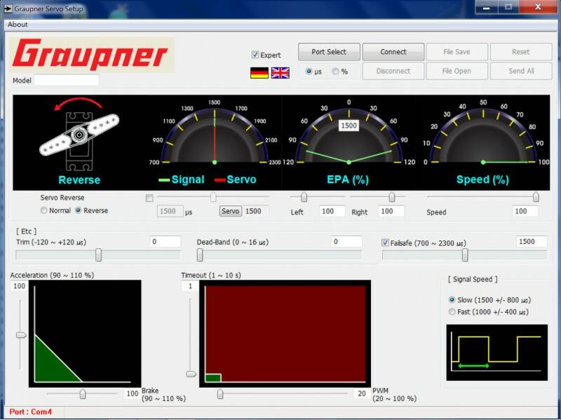

本軟體可適用Mega Power BLS系列 , 德國Graupner系列伺服機

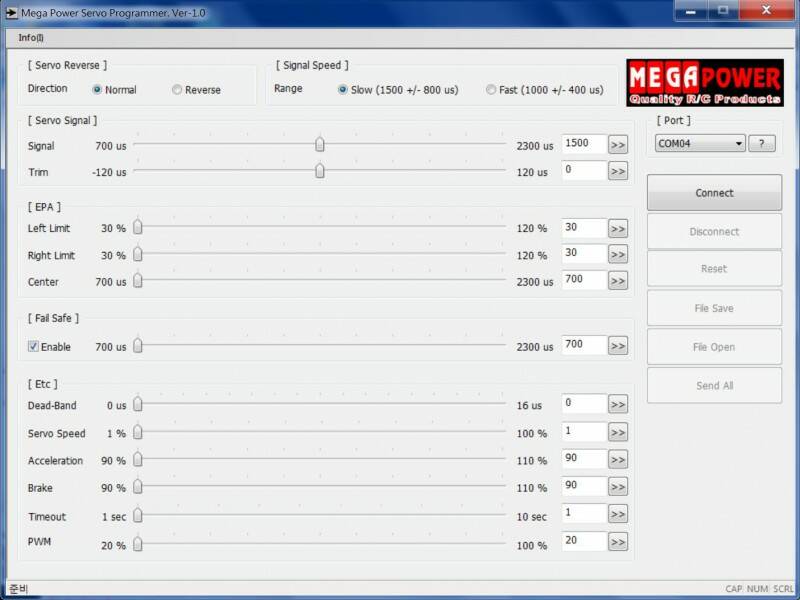

本軟體可適用Mega Power BLS系列 , 韓國SJ SSD系列, Hyperion系列, 德國Graupner系列伺服機
軟體功能說明:
If the software is installed and the servo to be programmed is connected, the following parameters can be adjusted:
·Model: here you can enter a name to save the settings under
·Servo reverse: Servoreverse: changes the direction of the servo's rotation
·Signal - Servo signal: after marking the check box, the servo can be moved with the slider, which shows the current position in usServo: clicking on the "Servo" button shows the current servo position in us
·EPA End-Point Adjustment: maximum servo travel separately adjustable for right and left
·Speed: Servo speed (100% = maximum), e.g. in order to adapt the servo speed for special functions
·Trim: Trim position for the fine trim adjustment of the center position - 100 ~ +100
·Dead band: Dead band setting: the higher the value, the greater the joystick travel from the zero position until the actuation of the servo
·Failsafe: Failsafe position; in order to activate failsafe, mark the check box and select a position
Can only be activated by marking the "Expert" checkbox
·Acceleration – Brake: adjusts the acceleration and braking behavior of the servo. 90 - 110%
·Timeout – PWM: Here you can adjust the behavior of the servo at full load. Example setting: Timeout 3 s, PWM 60%: if the servo is fully loaded, fully power is applied for 3 s, then reduced to 60
·Signal speed:
1.Signal type: Type 1 (slow, Wide Band): Setting for most servos, as well as for all Graupner remote control systems
2.Type 2 (fast, Narrow Band) for some Futaba or Sanwa remote control systems which require this setting.

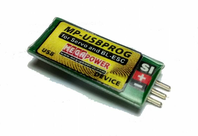

需另購MEGA POWER MP-USBPROG連接線
(可適用MEGA POWER, Hyperion, Graupner, SJ SSD等伺服機)

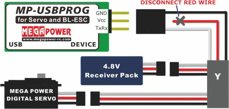

連接示意圖:
