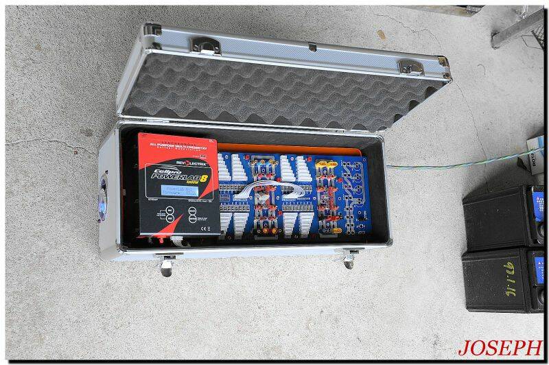

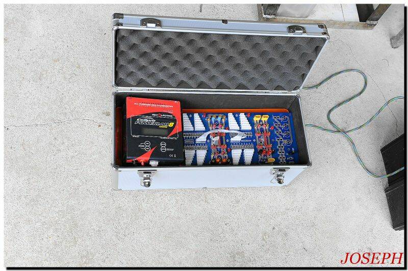

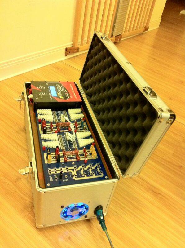

Check out this PL8 field charger with LED cooling fans. it has a custom PCB that can charge up to 8 batteries at the same time and it can take most kinds of battery connectors

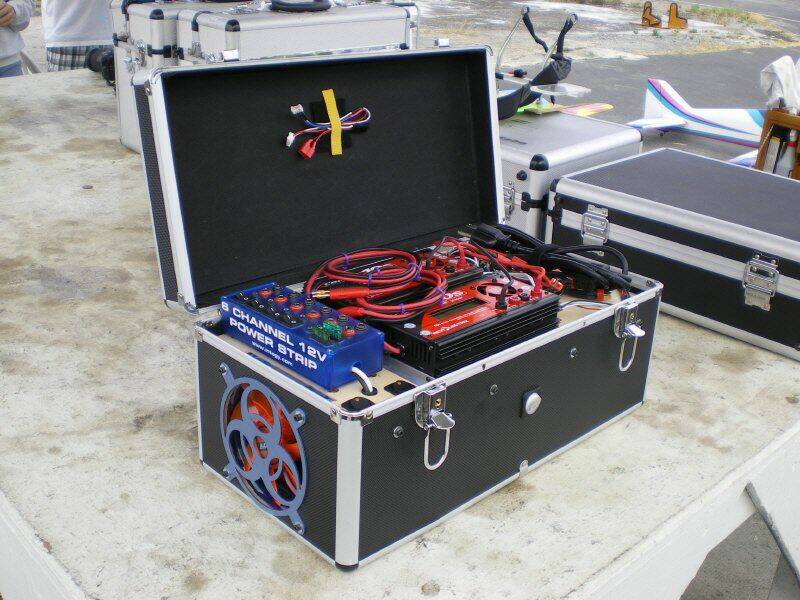

用FMA Cell Pro可充10S電池
參考一下我們用的裝備:
Iota 55A 12VDC電源供應器
兩組FMA Cell Pro, 可充兩組10S電池
一點建議: 散熱
1. 充電台要有風扇吹電池
2. FMA充電器本身的散熱風扇不夠,我的經驗要在充電器下面再加一個風扇
